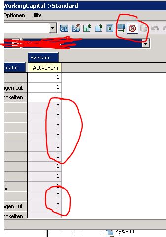

working on TM1 10.2.2 I have a simpe consolidation and want per C-Level Rule to set aome of them explicitly to 0 for Zero-Suppression even if Leafs are Nonzero. Cube-Viewer Shows me that the Elements are set correctly but Zero-Supreession does not work. Even with Zero-Supression the cells are shown!?

What you are attempting will not work. Overriding a consolidation, via a rule, to make it zero will not mean that node will disappear when zero-suppressed. Your only option is for all the leafs to be empty or for all of them to be weighted as 0.

What tomok is saying is right. You can therefore use 0 weightings to achieve the result you want. If the weight is 0 on all elements that have numbers in them then the consolidation will be hidden a zero-suppressed view. This applies whether you have a C-level rule on the consolidation or not.
