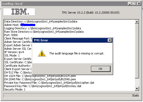

When I tried to start the local server, show the message Attached:

Do you have the tm1audit.lng file in your bin or bin64 directory? If not, or if it's corrupted, you will have to copy it from a working installation or re-install the software.

I tried to reinstall the software, (using the default configuration) and worked fine!
