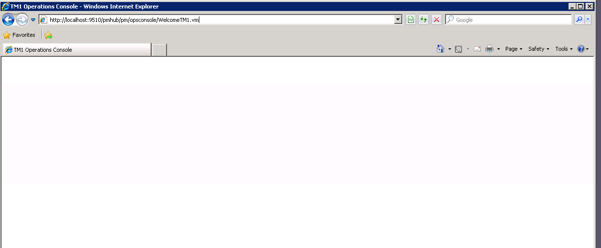

TM1 Operations console installed on same server where TM1 admin server,TM1 server and TM1 application server is insatalled. When i tried to enter operations console web page using url http://Servername:9510/pmhub/pm/opsconsole by entering TM1 server name and my login credentials TM1 Operations Console web page blanks out, It just opens an empty white page .
Did any one encounter simialr issue.
I am on TM1 10.2.2 . Windows server 2008 R2 Enterprise , IE 8 .
Error Screen shot
Error Screen shot

Got an update from IBM .TM1 10.2.2 Operations console is not supported for IE8 .Any IE version greater 8, Firefox,Chrome browsers should work with out any issue.
