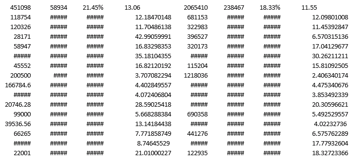

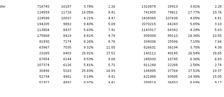

I'm working on 10.1.1 Cognos Express version with FP1 installed. I have some issue with report which using Active Form. Excel version working without any problem. When I open this report on TM1 Web it's looks fine but after refresh it using Active Button (with Rebuild Sheet option) I'm losing formatting from second row in active form. The first row has original formatting (number or percentage) but from 2nd row I'm losing this format.
Screens shot from this example report attached.

- Format after rebuilding Active Form
- Format after using active button.png (20.31 KiB) Viewed 3392 times
- Original format before rebuild Active Form
- Original good formating.png (12.32 KiB) Viewed 3392 times

First, probably silliy, question is: Did you provide the formatting in the formatting area?

Hi Will,
I don't know why but I haven't done it. After proper formatting it's working fine.
Many thanks for your suggestion. Sometimes simple thinks are hard to resolve
