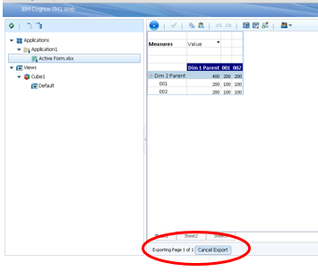

I have created Xcelerator Web (TM1 Web) applications for users. I need to snapshot these to Excel but after it starts generating the excel files it does not finish:
Export not finishing.PNG (28.12 KiB) Viewed 6411 times

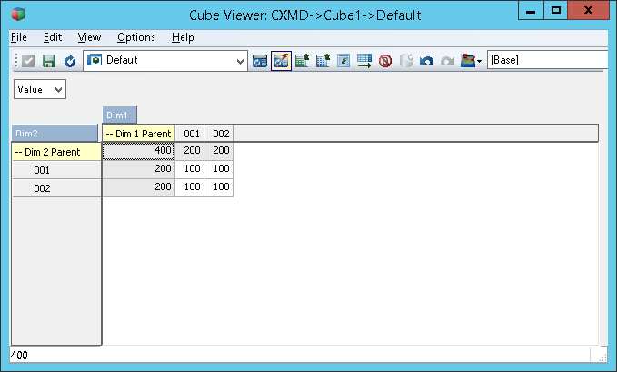

I created a simple cube with 3 dimensions and loaded some numbers:

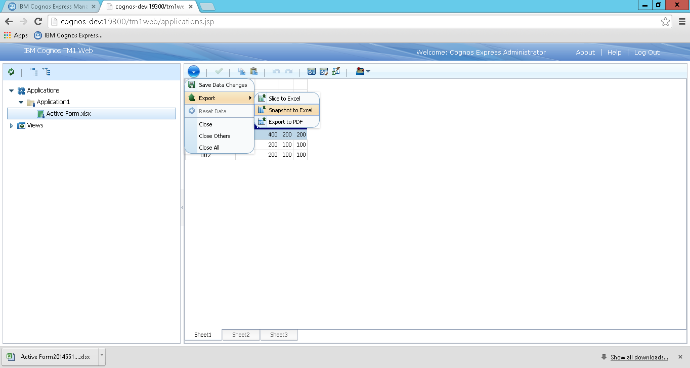

I opened this in Web and exported successfully
10.2 Web export.png (109 KiB) Viewed 6411 times

I opened the Websheet agani and tried to export it but it does not get past generating.
I can successfully export the cube view to Excel so I know that that feature works. It appears that only TM1 Web application fail. I created a snapshot, slice and Active form and they all fail to export.
