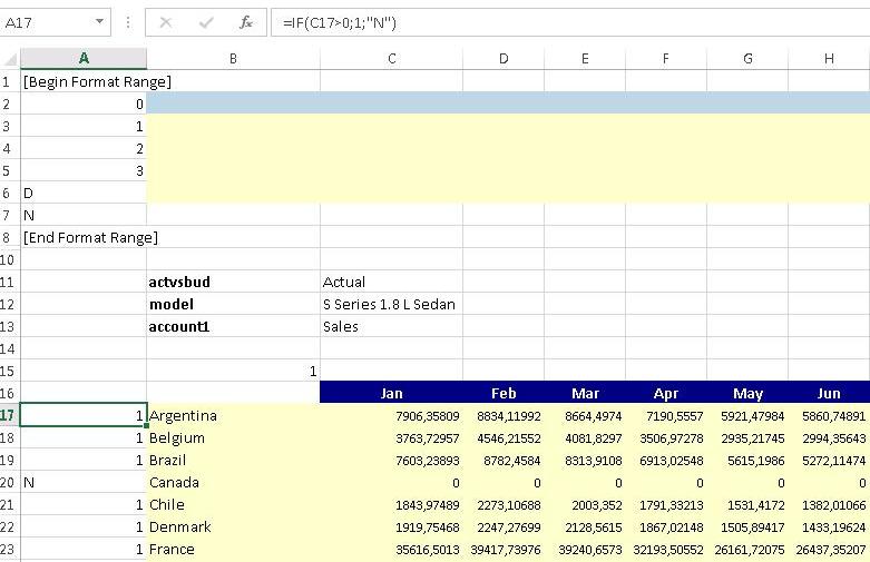

I'm newbie in the Active forms and I tried to create format based on the cube value
but it seems I did something wrong.
So in attached picture Active form based on Sdata sample.
The idea is simple - if the value in Jan>0 i'm using format 1 else I'm using format N
So you see that I write formula in column A for first row =IF(C17>0;1;"N") and you can see that for Canada in column A puts N
but anyway it shows in yellow if it has format 1
What do you think it is necessary to do?

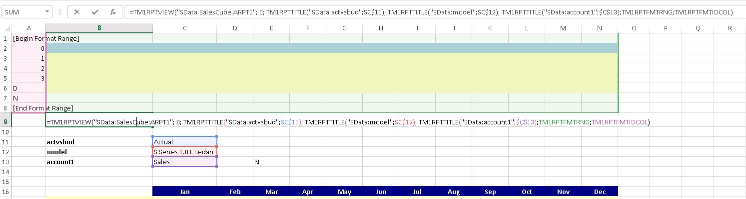

What is the range definition for TM1RPTDATARNG1, TM1RPTFMTIDCOL, and TM1RPTFMTRNG?

You need to consider the order in which Excel and TM1 are populating the cells that you are referring to during the rebuild of the active form. When the part of the processing that applies the appropriate formatting is executed, C17 is probably still waiting to be calculated.
Change your formula in A17 and replace the reference to C17 with the same formula that is in C17, but change the DBRW to DBR. i.e. =IF( DBR(<parameters>) > 0; 1; "N")

tomok wrote:What is the range definition for TM1RPTDATARNG1, TM1RPTFMTIDCOL, and TM1RPTFMTRNG?
I did the simple thing - create an Active form and connect to one view of one Cube on Sdata server.

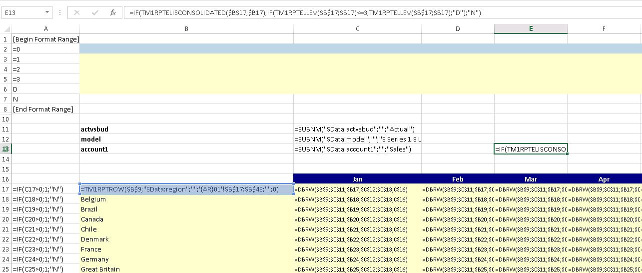

It put s the expression
=IF(TM1RPTELISCONSOLIDATED($B$17;$B17);IF(TM1RPTELLEV($B$17;$B17)<=3;TM1RPTELLEV($B$17;$B17);"D");"N")
in Column A - it works norvally
After it I changed this expression in A column to my one.
So you can see all formulas in the next picture.
And I don't know where I can see TM1RPTDATARNG1, TM1RPTFMTIDCOL, and TM1RPTFMTRNG

Andy Key wrote:You need to consider the order in which Excel and TM1 are populating the cells that you are referring to during the rebuild of the active form. When the part of the processing that applies the appropriate formatting is executed, C17 is probably still waiting to be calculated.
Yes. I tried it - it didn't help

Posted: Thu Jun 05, 2014 7:57 am
by EP_explorer
Found this parameters ))
You know - you were right. DBR helps (I tried DBRW).
