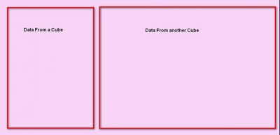

How about slice ?Can it work to place two cube data horizontally?
If not ? Is there any method to place two cube data into a template horizontally as follow?

Re: place multiple active forms horizontally
Yes, with a non-dynamic slice, this is no problem, you can set up two slices next to each other. Because the DBRW formula are just plain Excel formulae, they can reference cells anywhere.
You can try it by slicing to two different worksheets, then cut and paste (not copy and paste) one of them onto the other sheet.
