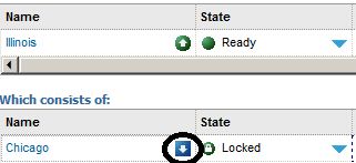

Hi, clic on reject does not working?.. see atachment.
- reject.png (5.58 KiB) Viewed 6379 times

Re: Behavior of workflow in Contributor?
Appreciate Your Inputs
In you example Jcortes
I know how to reject chicago. Now assume you have following city under Illinois Region
Chicago
XYZ
ABX
PQR
MNQ
UVW
Now i want to reject all the submission made by all city under Illinois Region but without clicking reject button individually on each city. Is there a way to reject all submission from region or by a single click.
I have a consolidation having more than 76 elements. Now it is cumbersome for reviewer to reject each city individually. It consumes extra time. Can we get rid off this as of now?
Chicago
XYZ
ABX
PQR
MNQ
UVW

- Posts: 1833
Dharav,
Your earlier post suggested that you wanted to reset the whole application to an unlocked state, if this is still the case - did you press this button as my previous post suggested you should?
Your previous post however suggests that you perhaps just want to reject all submissions under a certain node, is that actually the case instead?

Declanr
Yes it is the case. I just want to reject submission. I don't want to reset application because it resets all workflow not specific region work.

- Posts: 1833
The TI that rejects a submission is based on parameters passed into it so it wouldn't take much to build an extra TI that loops through all the children of a given element and executes the reject TI for the children. This wouldn't appear on the application screen but could either be ran by an administrator or placed in an action button on a websheet that is part of your application, allowing the users to execute it.
