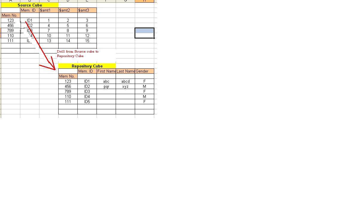

I tried another alternative where member's static details such as first name, last name, gender, etc..including the ID is stored against the member number in a cube (that acts as a repository). From Source cube if ID is drilled, it will open the repository cube to show ID and other demographic details. Eg shown below -
MemID Drill.JPG (56.11 KiB) Viewed 15546 times
Then from the original cube, I wrote a rule to pull data for Member ID at C level for all the members from that repository cube using DB.
Eg. [Member ID] =C: DB('repository cube', !Mem No.,, 'Mem ID.');
But when I save the rule, I get error for the !Mem No. (highlighted in bold) as incorrect string expression. In both the cubes, the property of this element is Simple.
Could you please let me know if the approach I used is correct and how to resolve this issue?
