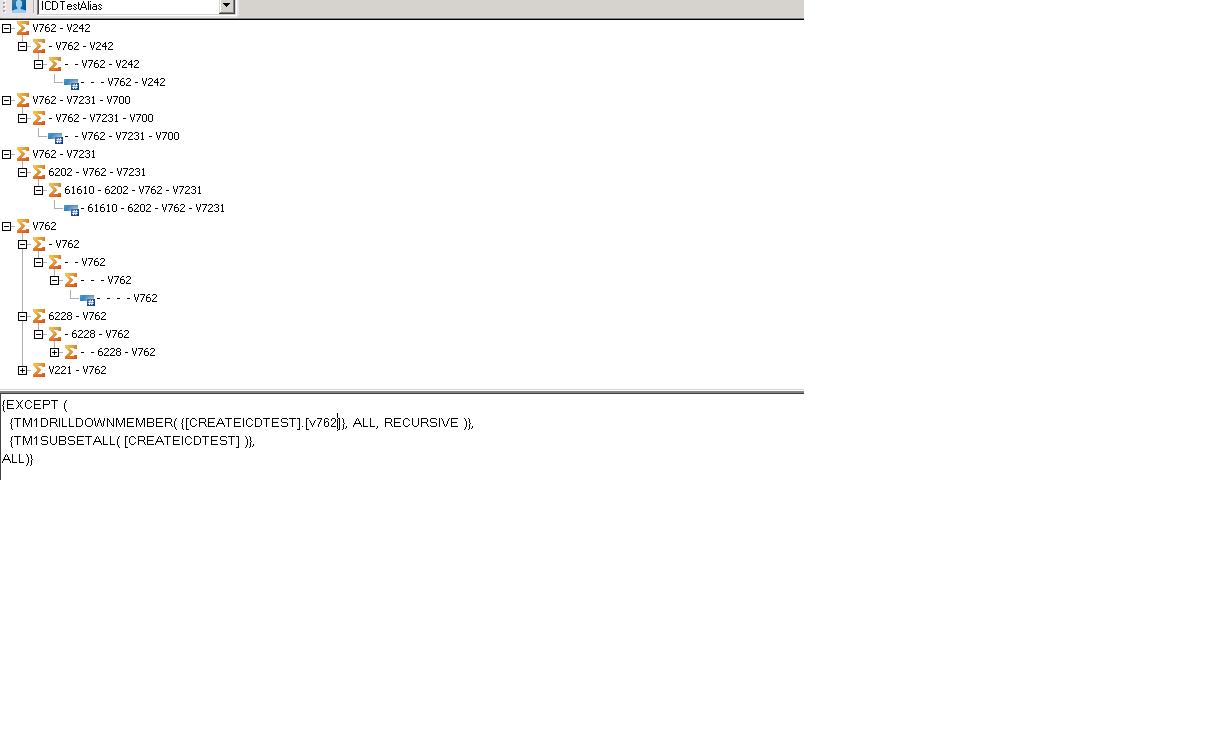

Robin, the dimension structure is such that it contains 6 levels and not all level contains a child element. Eg, as shown below, the element v762 contains children all the way to the leaf level in some cases and in some it does not contain any children. This dimension was built by setting all the levels to consolidation and the final level as element. Hence there are blanks (identified as '-') wherever child is not present. I tried pasting your code but on hitting update all the results disappear.rmackenzie wrote:our circumstances (odd results at consolidated level; no rules) point to double ups of elements in consolidations in one or more of the dimensions. You need to check every dimension in the cube that has consolidations to make sure there's no instance of an element being included twice, or more. You can use the MDX code snippet below to identify these problems - just paste it into the Expression Window in the Subset Editor and hit 'update' after you've replaced the dimension and consolidation names with those appropriate to your cube:
ViRa

Re: Incorrect Consolidation Calculation
That actually means that non of the elements are doubling up in that particular dimension hierarchy (i.e. v762 in CREATEICDTEST). If you hit Update and got a result, that would be the element that was potentially causing the problem. You should try the code in the other dimensions.ViRa wrote:I tried pasting your code but on hitting update all the results disappear.
Yes, there was indeed an element part of two consolidations and hence the incorrect calculation. I made the elements unique and correct results are being displayed now.
