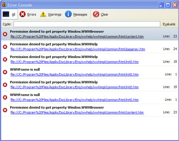

I checked the FF3 error log and it shows a number of errors as shown here
Firefox Error Log when loading TM1 documentation
They mean nothing to me of course :oops: except to say that there appears to be some sort of permissions issue going on here (Yes we CAN read up here in the North West)
J
