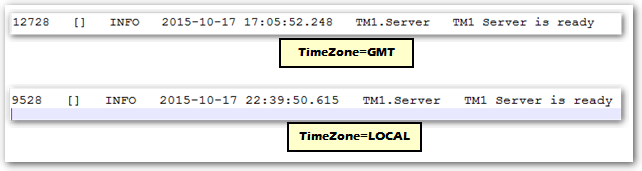

We have both of them (Timezone, Stargate) working in our dev environment. I did a quick test with a brand new TM1 instance and verified that, setting the TimeZone to local, actually changes the timestamps in the tm1server.log to the local timezone. See screenshot, attached.
tm1s-log.properties needs to be in the same folder where tm1s.cfg is present. Can you confirm where you have placed the tm1s-log.properties file?
