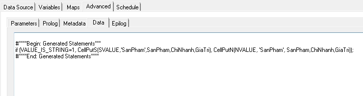

I also see the case as you. Process work fine when ran separately. I still do not understand why more and more 4 parameters like. Can you give me sample not.
Examle: I have process and code TI the same picture under
Thank you so much
