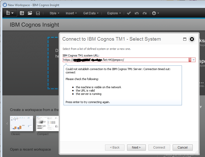

Dear TM1 Experts,
we're currently tuning a TM1 architecture (ver 10.2.1) designed to be used everywhere via web, also outside our corporate WAN.
TM1 server farm is running on the cloud, and successfully reachable using Cognos Insight (including SSL support) ONLY if there is no web proxy between the client and TM1 server.
Trying to connect the TM1 instance through a web proxy always results in error (please see the attachment below)
we tried unsuccessfully with several customizations of cognosrcp.ini

We tried as well local JVM configuration. Insight is always trying a direct connection, ignoring the system proxy.
Any idea?

just to recap the situation. Our AD domain is distributing the proxy configuration to all the clients via policies, using an automatic WPAD configuration script (resulting in the browser options as LAN Settings > "automatically detect settings").
It seems that Cognos Insight is able to read the System Proxy field only if explicitly configured in the browser > lan settings tab. In our case it's translating the entry as "direct connection", resulting in TM1 connection timeout.
The question is now how to force the usage of a specific https proxy Host and Port, manipulating the .ini files or equivalent.
I tried also changing the local JVM settings, unfortunately Insight is using a bundled stand-alone version of the Java machine, not the local system one.
It seems that proxy settings updated using the bundled JVM control panel anyhow available are not influential :
C:\Users\user.name\AppData\Local\Programs\IBM\Cognos Insight\plugins\com.ibm.jre7.win32.x86_64_10.2.1043.0\jre\bin\javacpl.exe
same story manipulating the java net configuration file:
C:\Users\user.name\AppData\Local\Programs\IBM\Cognos Insight\plugins\com.ibm.jre7.win32.x86_64_10.2.1043.0\jre\lib\net.properties
I suspect proxy logics have been hardcoded in the app :o
Last but not least, using 3rd party tools like proxifier (http://www.proxifier.com/) is not an option in our case.
Please help us! :cry: :?:
