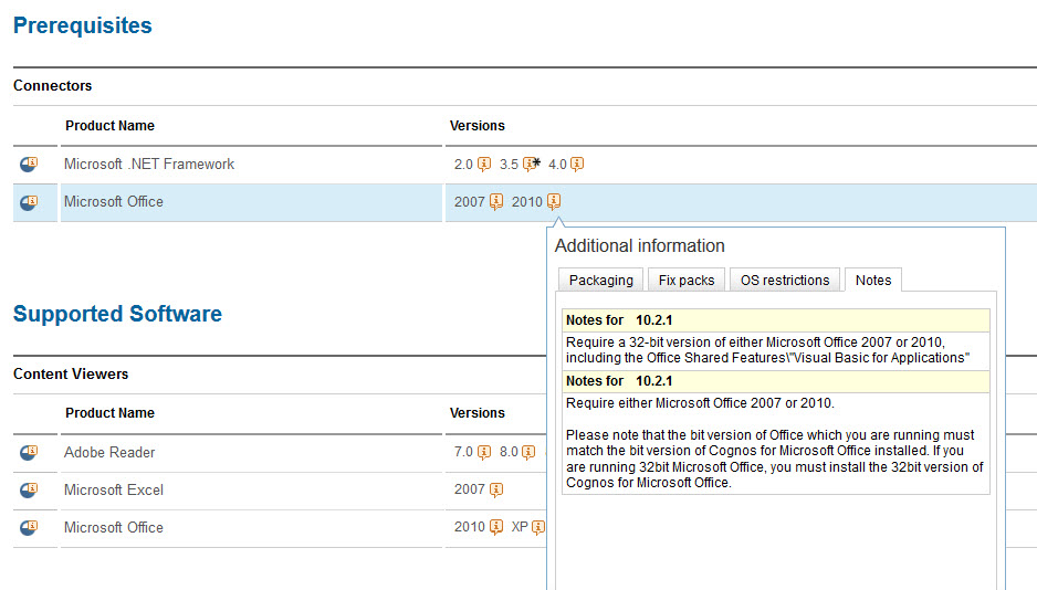

When i install Xcelerator, i get the following error msg INS-ERR-0075 The following prerequisites are missing. Please cancel this installation at the first opportunity and install them. "32-bit editions of Microsoft Office Excel 2007 or above"

winsonlee wrote:MS office 2010 64 bit should be supported.
Where exactly in those two links did you see it mentioned that the 64-bit version of Office works with CX?

Not openly, but in the second link there is a pop-up in the Prerequisites link that is as misleading as all getout and is recorded below for the sake of posterity in case they change it:
I don't think it's too unreasonable to believe that "bit version of Office... must match the bit version of Cognos" implies that if you're running 64 bit Cognos, well then, you go right ahead and use 64 bit Office, compadre!
Except that below that we have "Supported Software" links. (Links which interestingly list only "2010" and "XP" and not that abomination 2007 or the fine but overtaken by time 2003, but I suppose that those are implied.) When you click on those pop-ups, then there you will find a note that "only the 32 bit version is supported".

I have missed the info written on the"Notes" and when I saw the error msg mentioning "32-bit editions of Microsoft Office Excel 2007 or above", i I didn't realize the "Above" is referring to the office version and not the bits . After reading through the info posted by you guys, now it make more sense now. Would like to clarify on the following statement mentioning, "If you are running 32bit Microsoft Office, you must install the 32bit version of Cognos for Microsoft Office." When they mention Cognos, are they referring to Xcelerator Client ?
