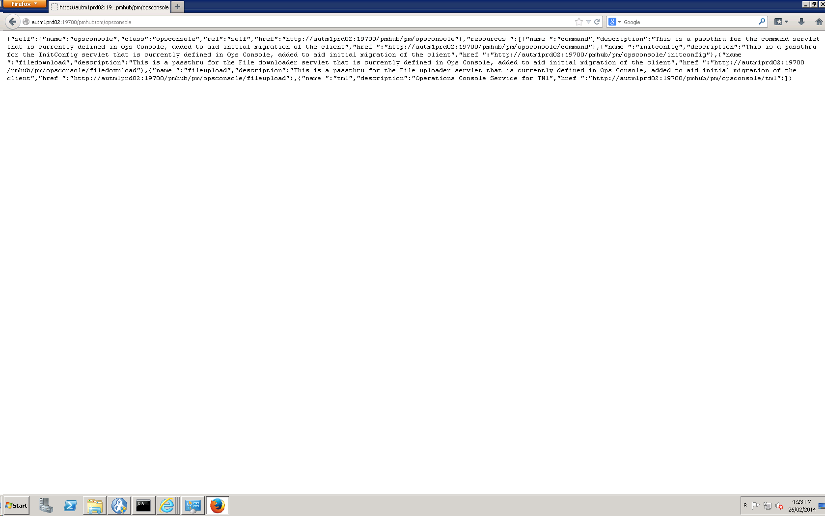

After installing CX 10.2.1 on Server 2008 R2 64-bit and trying to launch OPS console in Firefox I get this...
Has any one seen this weirdness before? Every other component works correctly: xclerator, tm1web, architect, ops consol admin etc...

I'm on my 5th attempt to get 10.2 installed. I can only suggest a re-install and before opening anything apply fix pack 1. Hopefully that will sort it.

Reinstall fixed the problem... Still curious what caused it
