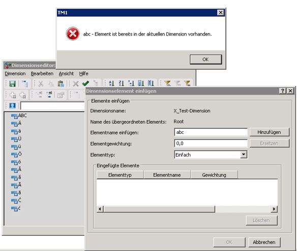

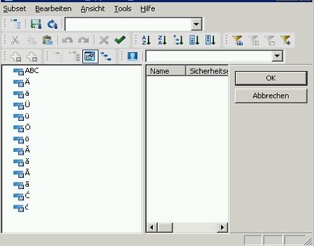

Re: Problem with umlauts in calculations
TM1 10.2.0 FP1 and TM1 10.2.0 FP2 are case sensitive with Umlauts like ä, ü, ö or á, ò in object names.
Just try entering element names in the Dimension Editor.
With "normal" letters you will not succeed.
When using DBRW() and entering the element names with the wrong case of the Umlaut, you will get a "key error", but typing all the other "normal" letters upper or lower case as you like it will be fine.
I haven't checked if UnicodeUpperLowerCase would have an effect on this behaviour.
- case_sensitivity.JPG (47.68 KiB) Viewed 5481 times
- Umlauts in TM1 10.2 FP1 are case sensitive in object names.
- case_sensitivity_2.JPG (28.1 KiB) Viewed 5481 times
