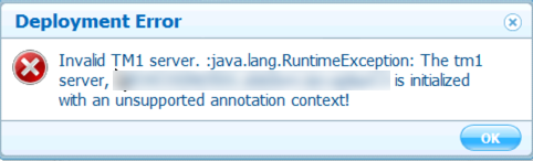

I would really like to use insight as a front end for an application I'm developing and tried the central application suggestion (very simple application, 2 views both from the same cube) but it won't deploy! There's some error about invalid annotation context.
Any suggestions? There is one CellAnnotations cube in the model but it's not part of the application and I already checked the cube and made sure it was cleared just in case.
Hi Lotsaram,
Check this technote.
http://www-01.ibm.com/support/docview.w ... wg21605744
Problem(Abstract)
While trying to deploy a TM1 Performance Modeler application an user gets an error; "TM1 is initialized with an unsupported annotation context! error.
Cause
The problem is caused by a corrupted TM1 model. A dimension called }AnnotationAppContextFacets ,that is essential to execute publishing of an application, is missing and is not created automatically during TM1 Performance Modeler startup.
Solution
1. Create a new TurboIntegrator Process,
2. Paste the code into in the prolog tab:
If (DimensionExists('}AnnotationAppContextFacets') <> 0);
DimensionDestroy('}AnnotationAppContextFacets');
EndIf;
DimensionCreate('}AnnotationAppContextFacets');
DimensionElementInsert('}AnnotationAppContextFacets', '', 'application', 'S');
3. Save and run the TurboIntegrator process to recreate the }AnnotationAppContextFacets dimension.
The deployment in TM1 Performance Modeler should work correctly after completing all those steps.

Thanks Tom, fixed the problem you da man.
