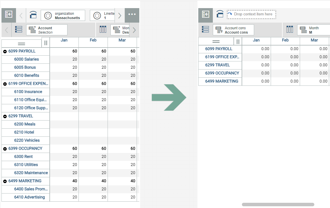

Question #20:
You have a cube with detailed costs data and a reporting cube where 1st cube's consolidated accounts are leaves. Write a rule and a feeder to pass data from 1st cube to 2nd cube
Image 54.png (98.31 KiB) Viewed 50712 times

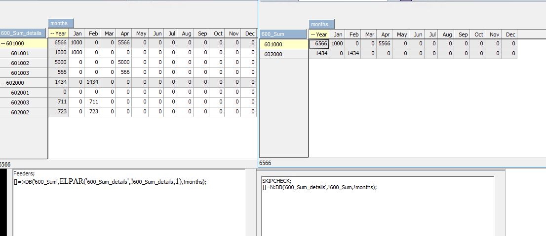

Re: Ultimate Long TM1 quiz
Posted: Mon May 20, 2024 9:11 am
by EP_explorer
Posted: Mon May 20, 2024 2:00 pm
by MarenC
As an alternative to ep_Explorer solution, I might be tempted to add an attribute to the Account dimension called, let us say, 'Feed Parent' and use that instead ELPAR, as an account could have more than 1 parent. And populate the attribute via TI as part of dim update process. Also ensure reprocess feeders is inserted where applicable!
Maren
Posted: Tue May 21, 2024 5:27 pm
by jwilliamson_uci
I could be mistaken, but wouldn't you also have to reference the context dimensions? Without knowing the exact order of the dimensions, shouldn't the resulting rule be something like:
SKIPCHECK;
[] = N: DB ('600_Sum_Details', !600_Sum, 'Total Organization', 'Total Line Item', !months, 'Amount');
I'm guessing that there is a measure dimension offscreen, and I've used "Amount" as my measure. The feeder remains as EP wrote it unless you want to use Maren's suggestion of an attribute.
Jeff

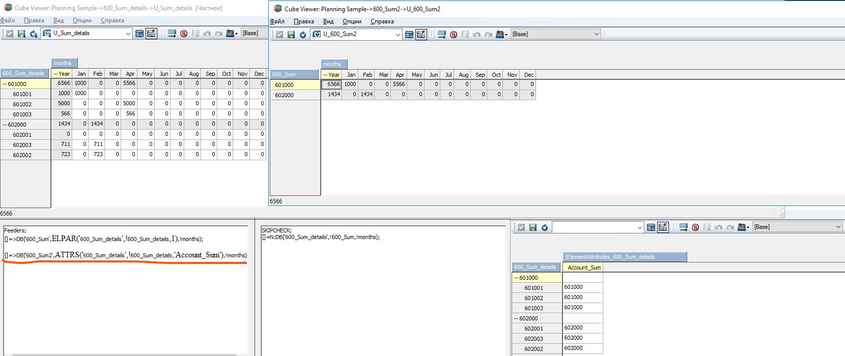

Posted: Tue May 28, 2024 4:20 pm
by Elessar
sorry for being late: was on vacation
Correct answer:
Will be this Friday, I think.
EP_explorer's rule works, but not in a way I would use: ELPAR is rather dangerous function here, because new consolidations can be created before the consolidations on screenshot, and we will need ELPAR(X, X, 2). Solution with attributes is better and MarenC could have earned this point if he wrote a rule. Thus, EP_Explorer is winning this round, and let's create a new question based on previous:
Question #21:
Write rule and feeder for the same task, but using attributes.
P.S. and yes, the idea of this question is to use correct approach. Dimensions in context, their order are not so important.
Posted: Fri May 31, 2024 6:59 am
by Elessar
Anybody? I will need to postpone next question until this question is answered.
Posted: Fri May 31, 2024 8:09 am
by EP_explorer
The MarenC's idea looks like
Posted: Fri May 31, 2024 8:16 am
by EP_explorer
In defence of idea of Elpar I could say:
The dimension of sum elements in conditions of the tasks seems is based on the dimension of sum and details elements
And if you add new sum element in sum and details dimension you have to after it change dimension of sum elements and elpar continue works if the structure of dimensions will not change.
If structure of dimensions will change - new levels appear - yes, using attribute is more resilient
Posted: Fri May 31, 2024 11:05 am
by MarenC
I somehow missed Question 21! I was just waiting for you to provide the correct answer. But I had assumed ep_explorer took the points.
Maren
Posted: Fri May 31, 2024 4:32 pm
by Elessar
Correct answer:
Is described here: viewtopic.php?p=83624#p83624
Also notice the correct mapping for feeder: it should be for each detailed element, not for consolidations themselves.
Thus, EP_Explorer is winning this round again!
