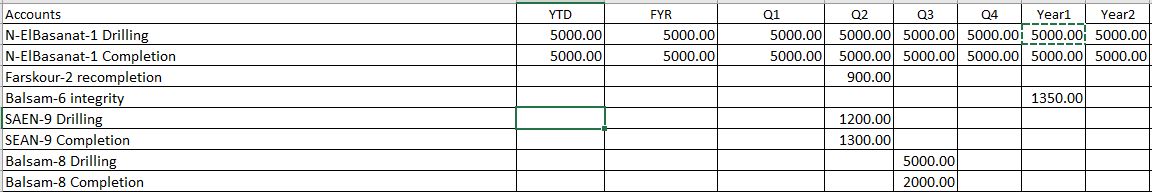

I have a problem to assign the file path in runtime.
I have made a ti process and select the type is File then assigned a template Excel file "Just contained a header" I attached it.
after that I opened the prolog tab : and wrote the following.
In the Data tab: I wrote the following as you see Just a simple code to check if it's okay or not.
If this doing well I will make a cube then put all my paths in it.
But, Unfortunately it doesn't work. Is there anything I missed ???

DataSourceNameForServer = 'C:\Program Files\ibm\cognos\tm1_64\samples\tm1\Test\Templates\ProductionData.xlsx';
Version = 'Plan';
IF(Accounts @<> 'Accounts' );
IF(DimIx('ProductionDim', Accounts) > 0);
CellPutN(Year1/12, 'Production','Jan 2018' , Accounts, Version);
ENDIF;
ENDIF;
Thanks in advance,
Best Regrads.

TIs don’t accept xls or xlsx etc rules as a source, it needs a flat file to read (CSV, CMA, TXT etc.)
I believe performance modeller could accept excel files but I think that just had an additional program that converted it to a CSV first, you can do something similar yourself by having VBS executed in the prolog to convert the xlsx to a CSV and then set the CSV as your data source.

Appreciated sir, You are right it worked.declanr wrote: ↑Thu Jul 19, 2018 10:00 am TIs don’t accept xls or xlsx etc rules as a source, it needs a flat file to read (CSV, CMA, TXT etc.)
