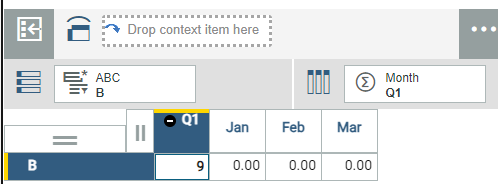

Question #11:
What will happen when data is entered to consolidated zero cell? For example:
Image 49.png (8.55 KiB) Viewed 43548 times
Re: Ultimate Long TM1 quiz
Posted: Fri Mar 15, 2024 2:17 pm
by ascheevel
I'll say it depends, but the default behavior since 9.5.2 is that the value inputted at 0 value consolidation will be spread evenly amongst the leaves. Since there are 3 leaf children, there will be a value of 3 in each month. If the TM1 admins have been bit one too many times by users spreading on zero at a very high level and they're on a version >= 10.2.2, they may have set the ProportionSpreadToZeroCells cfg setting to False which will cause an error popup when the user tries to spread on zero.
Posted: Fri Mar 15, 2024 2:32 pm
by MarenC
Am I the only one who has made this the law!
Posted: Fri Mar 22, 2024 3:37 pm
by Elessar
Correct answer:
I'll give a link to ascheevel's answer: viewtopic.php?p=83320#p83320
Nothing to add
Winner of this week is ascheevel!

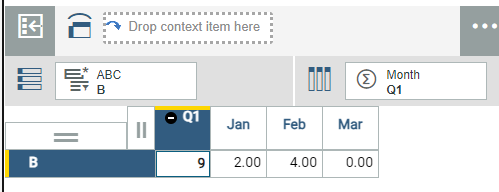

Question #12:
What will happen when data is entered to consolidated non-zero cell? For example:
Image 50.png (8.9 KiB) Viewed 43434 times
Posted: Sun Mar 24, 2024 6:42 pm
by ardi
Data will be spread to leaf cells proportionally with existing values.
In this Case:
Value of January will change from 2 to 3, and value of February will change from 4 to 6. Value of March will remain zero
Posted: Wed Mar 27, 2024 12:35 pm
by MarenC
Assuming Consolidation TypeIn Spreading is not set to Deny then what ardi says (assuming the user wasn't an Admin)!
Posted: Fri Mar 29, 2024 10:43 am
by Elessar
I'm on vacation, so next question will be on Monday. Stay tuned
Posted: Mon Apr 01, 2024 8:52 am
by Elessar
Correct answer:
Value will be spread to non-leaf cells proportionally if a user has admin rights or if Consolidation TypeIn Spreading is not set to Deny.
Winners of this week are ardi and MarenC! Both are getting 0.5 points

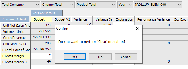

You are looking at a screen showing the entire budget for you company in Architect. All data is written and stored in this cube. You are copying the company sales total to an email when you realize your finger slipped on the control key and you entered "C" not "Ctrl -C", and then your cat is pressing Enter twice. Moment later, SaveDataAll chore is running. You are trying to undo your operation, but nothing happens. You are checking }Cubeproperties: logging is set to "NO". You are frantically searching for backups, but the last backup is 2 months old: backup disk space has run out.
What are your next steps?
