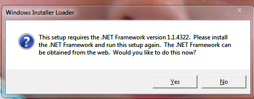

However I can't use the documenter tool Its says I need the XmlDiffPatch tool
But the XmlDiffPatch says I need .net 1.1.4322
Xmldiff tool
Xmldiff tool
So I ended up here
http://sticklebackplastic.com/post/2007 ... tools.aspx
Trying to recompile the msi to run in .net 4 to avoid the .net check
I couldn't find the "CustomAction" and that's when I gave up
Any chance this can either not use xml diff or use come provided with a more recent version that doesn't need .net 1

Sorry guys, I was checking this post, but didn't realize it had spilled onto a second page!
First, the requirement for XmlDiffPatch will be removed in the next release, so for those having issues with that, the easiest thing to do is wait.
Second, the check for up.date during start up. I will be making this an optional feature in the next version, and it will be much less intrusive (i.e. it will gracefully fail when there is no internet connection, and will have a setting to turn it off).
If you need any further features beyond that, let me know and I'll try to accommodate it. I should have a new release of all the flow tools ready early next week.
