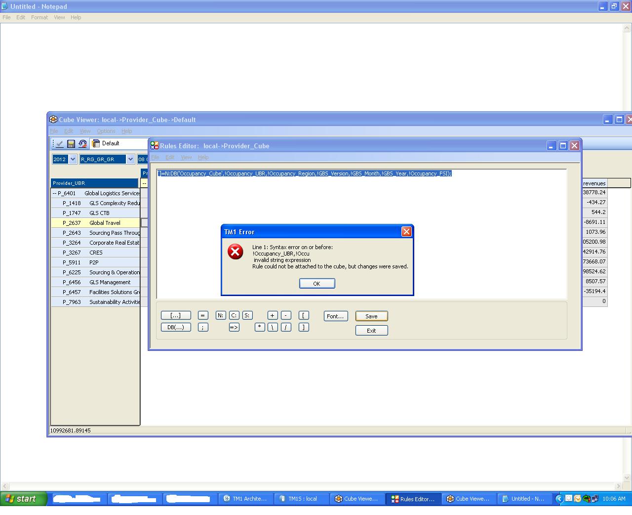

But please do not say help is not required in my situation. I am alone in this project trying do that but i am facing errors.
That is why I have posted.
The rule is still giving errors.Find the attachment.
Thank you very much for your support.
- Rule_error.JPG (132.05 KiB) Viewed 4702 times

The information that Tomok asked you for in his very first post was the information that was needed to resolve the issue, but instead of supplying that you supplied some screenshots which didn't give it. Then you rubbed salt into the wound by saying that you had supplied the information which, in fact, you hadn't. That's bound to put some noses out of joint.
Nobody's saying that you don't need help but the other issue is that you don't seem to have done one main thing to help yourself, which is to read through the Rules Manual because you seem to be missing some basic understanding of how rules work.
(And in relation to your follow up question, bear in mind that it's Easter weekend. Even TM1 gurus have down time occasionally.)
Now, turning to your specific question, consider the following:
(a) You are creating the rule in the Provider_Cube, right?
(b) The rule is pulling a value from the Occupancy_Cube via a DB function.
(c) The DB function must contain the name of an element for each of the dimensions in the Occupancy_Cube, agreed?
(d) Now the question is where to get the names of those elements.
You have two choices. You can either hard code an element name by putting it inside single quotes. Or, you can derive the element name from an element that exists in a corresponding dimension in the Provider_Cube. As others have already explained, you do that by putting an exclamation mark before the dimension name.
Now look at what you've typed; []=N:DB('Occupancy_Cube', is OK, but the next bit is !Occupancy_UBR. You are telling the rule to take the element from the Occupancy_UBR dimension and pass it into the DB function. BUT... the Provider_Cube doesn't have the Occupancy_UBR dimension in it. It has the Provider_UBR dimension. Consequently the rule has no idea what you are talking about, because you need to supply the source of the element name to the DB() function. You therefore need to use the expression !Provider_UBR, not !Occupancy_UBR. When the DB() function does the lookup it'll punch that element into the formula to seek the corresponding !Occupancy_UBR element. The same situation will occur with the _FSI dimension. If you look at Tomok's post at the head of page 2 of this thread, you'll see that he has in fact told you this. Try making the change to those two dimension names in your formula and see what the outcome is.
