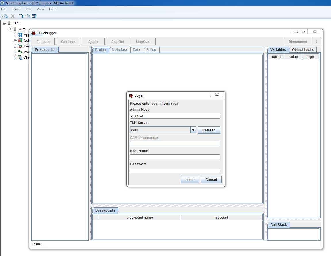

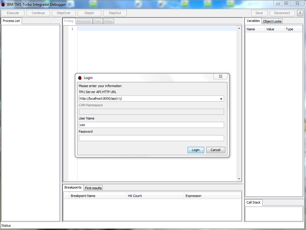

Unfortunately the TurboDebugger has changed since August, when I could test it.
Then there was a log in prompt which is straightforward: admin host, TM1 server, username, password.
Now we are asked for "TM1 Server API HTTP URL".
What would it be in a typical TM1 installation ?
I tried with port 5895 as well but it does not work. No error message either.
Any ideas ? Thanks !
Re: IBM Planning Analytics On Prem
Posted: Thu Dec 15, 2016 11:39 pm
by Edward Stuart
The default path in my instance after downloading and saving to my local hard drive points to:
http://localhost:8000/api/v1/
I've setup my Planning Sample instance to point to 8001 in the tm1s.cfg file
# Amendment to tm1s.cfg file for TM1 REST API Connection
HTTPPortNumber = 8001
Therefore, in my instance I have changed the login link to:
http://localhost:8001/api/v1/
Works a charm
Posted: Thu Dec 15, 2016 11:44 pm
by Wim Gielis
Hello Edward,
I got it too now with the help from Google.
Such a line in the cfg file was indeed missing.
