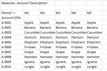

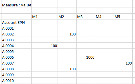

I thought I would have one crack at explaining this with a simple 3d cube dimensioned by account / month and measure
The account dimension has these attributes
The cube has this data, note the sparsity, the blank cells do not exist in the cube and do not use resource.
If I pull the attributes into the cube I get this. This data is now fully dense and all cells are populated with strings, which use more space than data but that's not the point, it is the lose of sparsity that is the real issue.
This is where the responders are trying to point where your design is going wrong, as this example scales in a production system you will grind to a halt.
