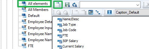

Question #45:
I've created a subset in Architect using "All" button. After I had saved it with "All elements" name, it is shown with static subset icon. Will new elements appear in "All elements" dimension after I add them to the dimension?
Image 71.png (13 KiB) Viewed 54630 times
Re: Ultimate Long TM1 quiz
Posted: Fri Nov 08, 2024 9:38 pm
by ascheevel
Yes, parameter 278 in the sub file will have a 1 which dictates that the subset, despite being static, will be populated with all elements in that dimension anytime it is referenced or opened. As such, there also will be no element count parameter 270 in the .sub file or the list of static elements following it.

Correct answer:
Yes, they will.
Winner of this round is ascheevel!
