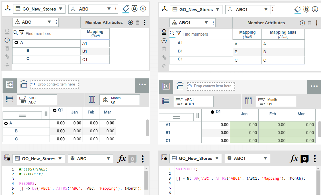

Question #37:
Source cube is without skipcheck, target cube is with skipcheck. Will feeder fire from cube without skipcheck?

Re: Ultimate Long TM1 quiz
Posted: Fri Sep 13, 2024 9:48 am
by EP_explorer
Yes - feeders will fire
Posted: Fri Sep 13, 2024 1:54 pm
by MarenC
I am sure I have had issues with this in the past so I will say No. Hopefully you will tell us the exact cases where it will and won't, as that would be helpful!
Posted: Fri Sep 20, 2024 5:10 pm
by Elessar
Correct answer:
Yes.
I know that they did not fire in 9.5.2. What version they begun firing on - I do not know, but in Planning Analytics they definitely fire.
