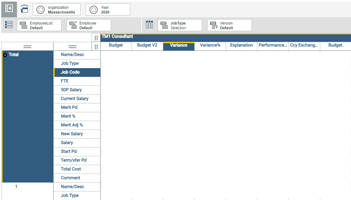

Question #36:
Different formats are set for all dimensions in a cube. Which one will be displayed?
Dimension order in cube is following:
  1. Organization
  2. EmployeeList
  3. Year
  4. Version
  5. JobType
  6. Employee

Posted: Fri Sep 06, 2024 4:24 pm
by MarenC
I believe the Version Format will be displayed because that is stacked on the column and is the last dimension on the column.
Maren

Posted: Mon Sep 09, 2024 1:00 am
by ardi
TM1 applies the formatting of the Most inner Row dimension, in your case it would be the formatting defined in your Version dimension.
Just curious: What you have called as Employee Dimension seems to be your Measures dimension in the cube?
