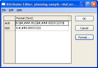

I don't know where that formatting came from; but from the 4 segments (positive, negative, zero and text) and the underscores to allow indentation for the brackets, it looks like Excel formatting. That's not the same as TM1 formatting. For a start the 4th argument (to format a cell as text) is meaningless in the context of a TM1 cube since an element will either be N, C or S anyway.
The code for a display of two decimal places in TM1 should look more like the screenshot below. (AUD is 2 decimal places currency with comma, and with negatives in brackets, NZD is 2 decimal places with comma.)
I suggest that you use the [Format] button in the Attributes Editor to modify the format.
Bear in mind that this only affects cube viewer, not any slices that you generate from it.

Alan Kirk wrote: I suggest that you use the [Format] button in the Attributes Editor to modify the format.
That did it!!! Thanks a bunch!!! You rock!! :twisted:
