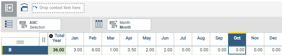

Write a rule to make not SUM, but PRODUCT of descendants in consolidated elements:

Don't think anything new in planning Analytics solves this, so the old method should still work.
Create a new measure called MinusValue
Rule for MinusValue is:
['MinusValue']=N: IF(['B']<0,1,0);
Create a new measure called NatLog
Rule for NatLog is:
['NatLog']=N:IF(['B']<>0, LN(ABS(['B'])),0);
Rule for C Level is:
['B']=C:EXP(['NatLog']) * -1^['MinusValue'];
Old method is outlined here: viewtopic.php?p=26007#p26007

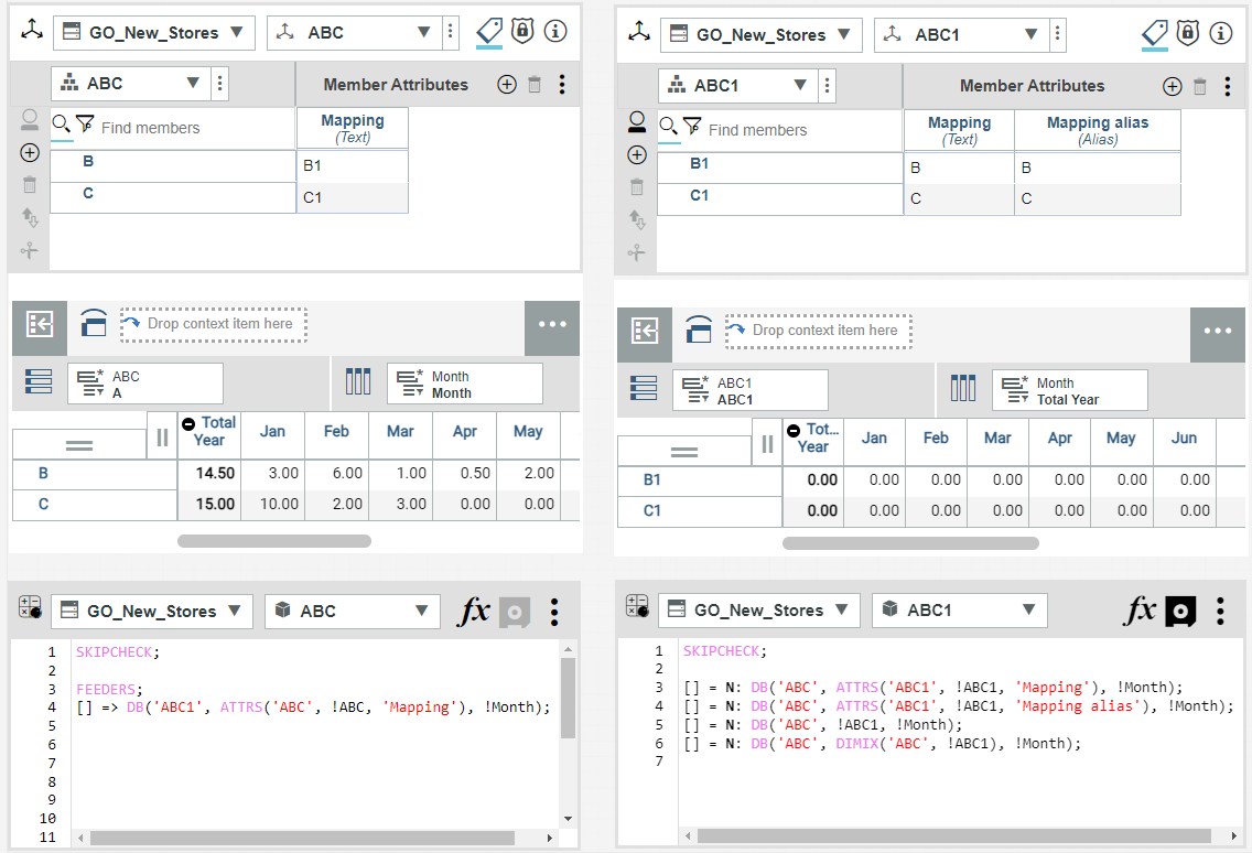

There are 4 rules to transfer data from ABC cube to ABC1 cube. Which of them will work correctly? Which is the best?

I believe the first 2 rules in your screenshot will work and the other 2 will error, as ABC1 is the not the primary name of the element in ABC.
Funnily enough I don't know which of the first 2 is best, be interested to see the thinking behind the answer to that one. But given you are feeding from a text attribute I will guess that the first rule is the best one to use!

I like the first choice the most but would opt for DB against }ElementAttributes vs ATTRS as wiser people than me have said it’s faster.
I don’t like the Alias approaches as that doesn’t scale beyond 1 to 1 mapping. Same for DIMIX, that doesn’t scale when element order is different between ABC and ABC1.

1st and 2nd will work. For "What is best" - it's a discussion question, firstly to discuss what mapping is better to use - text attribute-based, or alias-based. I prefer text attribute: this allows you to make not only 1*1 mappings, and also allows crazy mappings like "Map ABC1's B1 to ABC's C1".
And also, thanks Adam for note: Cubewise has proved that DB(}ElementAttributes...) works faster than ATTRS: https://code.cubewise.com/blog/7-tips-t ... ics-rules/

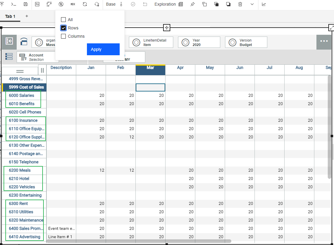

A user has suppressed zero rows and wants to save list of non-zero accounts to a private subset. How can he perform this?

What I always do is apply "suppress zeros" in the rows. Then, I select all the elements in the rows of the suppressed view by clicking on the row header. Next, I right-click on any element and choose "keep". In the subset editor for the dimension in the rows, the subset I want to save will be on the right side. Finally, I choose "save as" and select "private".

  1. michalb's one: "I select all the elements in the rows of the suppressed view by clicking on the row header. Next, I right-click on any element and choose "keep". In the subset editor for the dimension in the rows, the subset I want to save will be on the right side. Finally, I choose "save as" and select "private"."
  2. Export to excel, copy-paste accounts to subset editor
  3. Write an MDX pointing to cube (need to know MDX)
  4. (for mammoths): In Architect, save view and use filter by view extract
