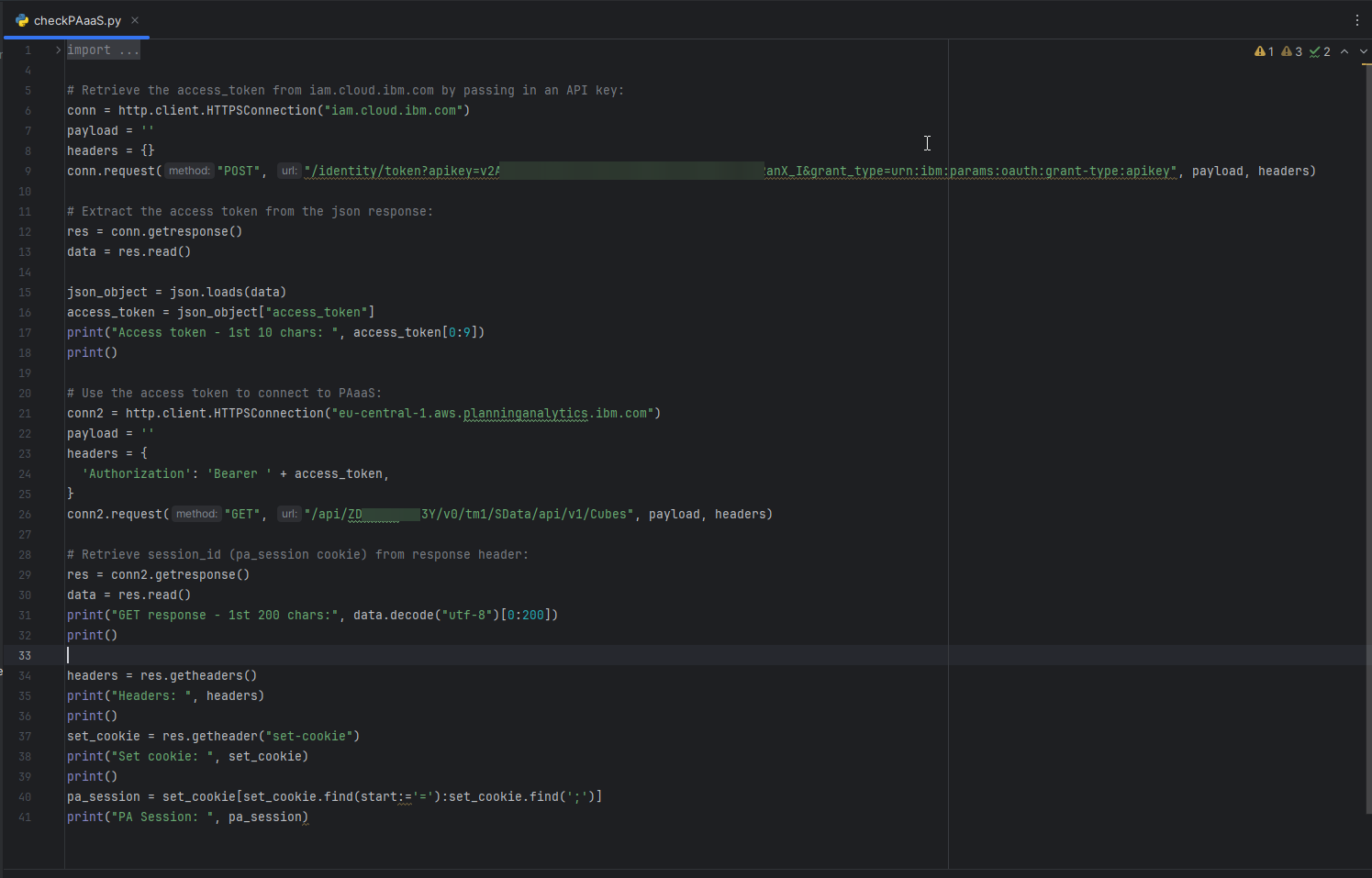

The cloud instance is accessed using this URL format: My first test was to see if I could connect to the server - I used the code below to firstly get an access token from the iam.cloud.ibm.com site by using the API key that I had previously generated, and then using the access token to connect to the cloud server. This seemed to be successful because I was able to display a list of the cubes in the SData model. Here is a screenshot of the code:

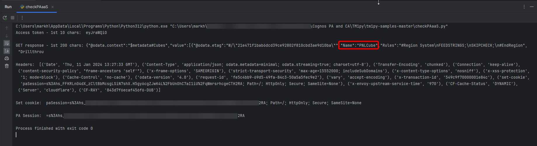

... and here is the output:

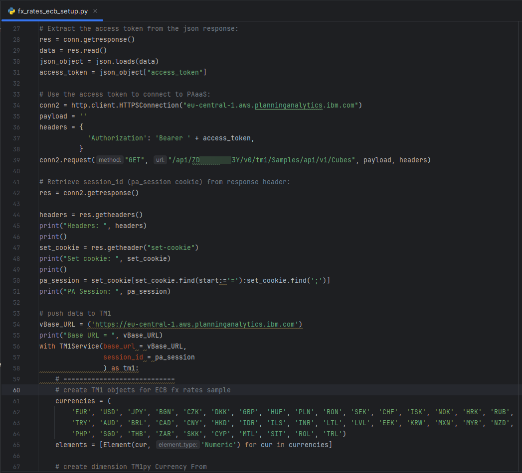

I tried tried the code below which passes in the session_id parameter:
Code 2.png (113.84 KiB) Viewed 13374 times
However, I got a 401 error in my output (sorry no more screenshots - I've reached my limit of 3!).
