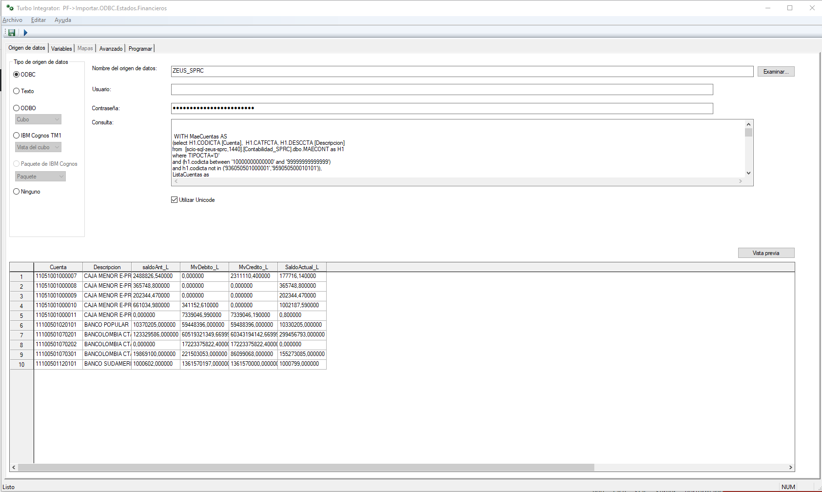

I have a TI with ODBC as Data Source and I am using an SQL query previously tested in SQL Management Studio and directly in ZEUS (Accounting software) by IT team but "sometimes" the process fails and returns this message:
Error: Data procedure line (0): SQLState: 01003 SQLMsg: [Microsoft][ODBC SQL Server Driver][SQL Server]Warning: Null value is eliminated by an aggregate or other SET operation.
After read about this error I understood this is only a Warning (triggered when Aggregate Function ignores a null. See an example here:https://blog.sqlauthority.com/2015/02/1 ... operation/) value instead of Error.

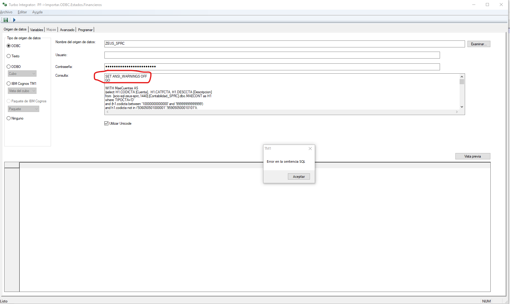

The first solution is to set ansi_warnings OFF in the execution time.This is possible with just execute this instruction:
SET ANSI_WARNINGS OFF
BUT, when I Put this line before the SQL Query it returns a sintax error... I think Turbointegrator only can process SQL Queries or Call Stored Procedures but not execute this kind of instruction...
This is the query working:
This is the error in log when the case happen:
This is the error when I try to fix it adding the instruction:
This is the SQL statement:

It seems like I am answering the question by myself but, I really have some limitations: IT team confirmed that we can´t create Stored Procedures in this accounting software.
So, I am asking you if maybe you can show me another solution:
Do you know another way to avoid this warning when I run the TI ? OR
Do you know any way to say TM1 doesn't read this warning like an error?
Thank you very much for read and help.
