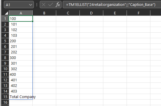

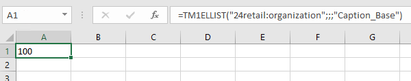

We are facing a problem using PAfE 2.0.81.3 with PAW 2.0.79. PAW server and database is the same in this test.
On one side I use my personel notebook with Office 365 x86. For example we tried the formula =TM1ELLIST("24retail:organization";;;"Caption_Base"). The result is a list of the elements of the dimension as expected.
On the other side we have a Terminal server with Office 2019 x86 using the same formula, the result ist only "100". See screens attached.

PAfE - TM1ELLIST - returns just 1 element
- Terminalserver.png (6.47 KiB) Viewed 2191 times
- Notebook.png (16.16 KiB) Viewed 2191 times
