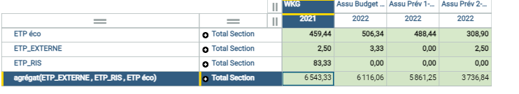

Newbie in PAW, i have a question about Insert Calcul
I just notice a weird calcul
I want to insert a sum of ETP eco/ ETP_EXTERNE / ETP_RIS ==> but i got this result is not a sum at all
bad result.png (28.02 KiB) Viewed 5025 times
i try with another thing, then the result is good

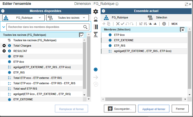

ETP and 200069 is in the same dimension but not in the same hierarchy
Both value is in consolided element and both is calculed by rule.
fg rubrique.png (49.94 KiB) Viewed 5025 times
what can be the source of this problem?
It can be solved by add more mesure but i dont want to add something that i use only 1 time in this report.
