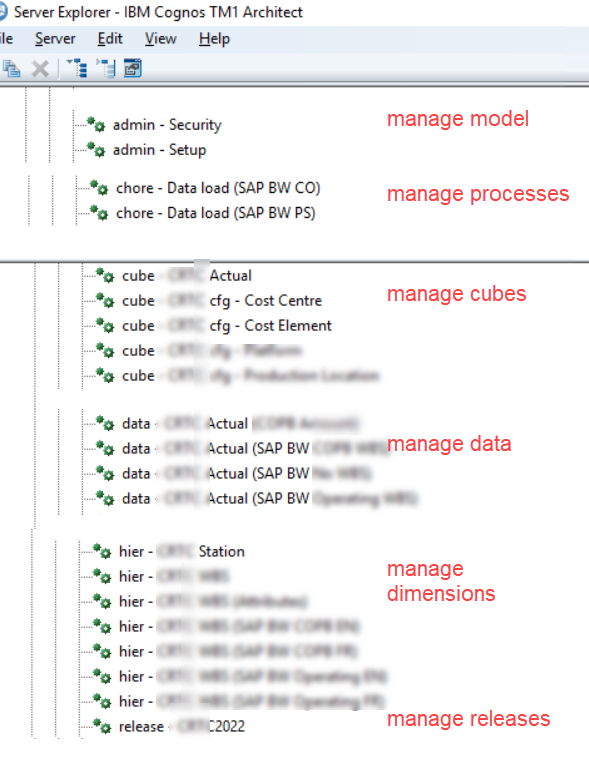

Let me share my personal approach. I always create a separate process to manage each cube and dimension. My process list looks like this:
So for instance, cube - Cube1 process is used to create/update/recreate Cube1 cube, cube measure dimension, cube views, cube rule and cube security rule.

  • if I ever need to change something for Cube1 (like create a new view or measure dimension element), I simply make such change in the cube - Cube1 process
  • the same is for dimensions, I have hier - Dim1 process to create/update/recreate dimension/hierarchy/elements, setup/localize attributes, create/update subsets, etc.
  • if I need to deploy my changes from DEV to QA, I simply deploy the cube - Cube1 process and execute it in QA
  • to make sure the security is up to date, I simply execute the admin - security process
  • using release - * processes, I can bundle multiple changes and deploy all of them to a different environment
  • naming/development convention makes the life so easier, especially when there are >1 TM1 developer
I use my own TM1 Framework, similarly to Bedrock, it can automate many things (create dimensions/cubes/views/subsets, import/export/copy data, admin object security, etc.)
