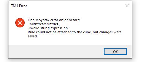

Thanks for noticing the misspelling, but the error occurs earlier. Syntax error on or before: ' !Midstream Metrics , invalid string expression etc. See attached.

The invalid string expression error is normally arising from a !dimname reference to a dimension that is not in the cube in which the rule is written, as suggested by Declan
As others have said, it seems that the most likely answer is that there is a basic syntax / dimension reference error in your rule.
