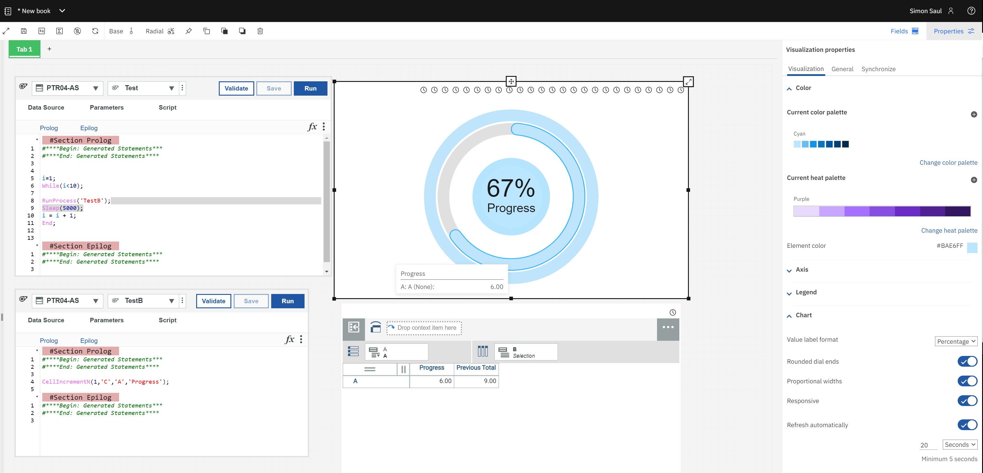

Attached is an example to give food for thought
The problem you'll be experiencing is that the cube doesn't reflect the progress until the process has finished, to get around this you could start an alternative thread to make the updates to your TI.Monitoring, that thread will then complete before the main process has finished (if there are spare threads available_ and will bring the cube closer to real-time. In the example the process test is calling process TestB every 5 seconds to update a cube "C".
The graph/cubeview in Workspace has then been set to refresh automatically, currently every 20 seconds, but you could tweak this...
You could also do something similar if you wanted to show completed steps...
Just be mindful of how many threads are being spawned and the frequency.
Another option is you could use run a powershell command with the TI process to export incremental updates to csv (allowing multiple processes to update the same file) and then update the TM1 server in a batch at the required frequency, using a chore...

- Example.png (346.26 KiB) Viewed 3743 times
