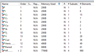

Here is one of my cubes with dimensions:
So it's a bit confusing, can someone explain?
