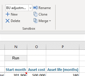

How do I publish a Websheet with an action button? When published .xlsx files are not shown in the application folder. Also, when selecting the sandbox in excel it is the same as for the workspace. It is not set for the whole session.

They need to be saved as XLSM to include buttons nowadays... I think it is supposed to prompt you to save as XLSM first when you try and publish.

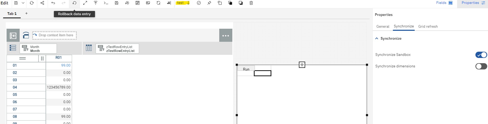

When you publish from within PAX you need to make sure to tick "make public" etc but any XLSM file should definitely show up in PAW if you successfully publish it. You need to make sure that PAW is configured to point towards your TM1 Web server so that it can actually render the websheet, but even if not configured you can still drag in websheets - they just render as a white page.
In terms of getting it to work I did a very small basic test with a single TI in a websheet, set to change a single cell and with the active sandbox property set.
On a PAW sheet I have a cubeview (exploration), set to sync sandboxes.
And the websheet, also set to sync sandboxes.
In the cubeview I created a sandbox. Then ran the TI process and it updated the value in the cube against the sandbox - showing in blue.
- Screenshot 2021-06-23 173958.jpg (73.57 KiB) Viewed 9819 times

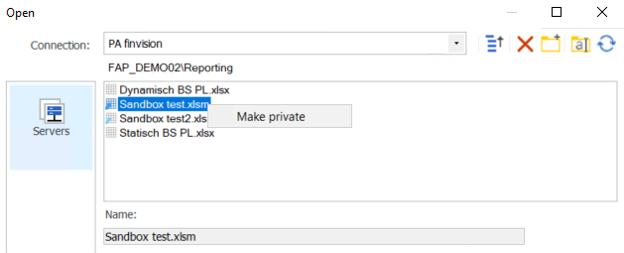

However, published .XLSM files are not being shown in the workspace. (they are public).

I *think* that blue arrow symbol you have is for when it has been published with "add file as a reference" selected.
If you try it without ticking that, they should show in PAW.
