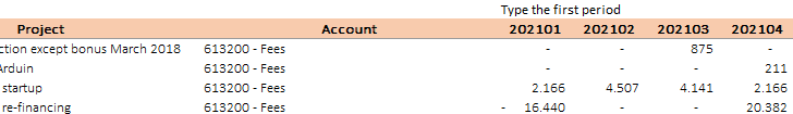

I am having an issue with supress zeros in a dynamic report.
When the first column element is typed, supress zero’s works correctly.
When the first column element is selected via a SUBNM("PeriodMonthly";"Base";"202101") dropdown,
the other column elements are no longer taken into account.
How does the suppress zero functionality recognize column values?
Any Ideas?

Usually, I derive 12 periods from a single subnm selection cell.
The problem that I am having is that the column (period) information is not used as input, unless I explicitly type a period in one of the cells.
Some additional information:
- My ranges go far enough.
- The period dimension is not specified in the tm1rptview.
- The DBRW formulas are referencing the cell with tm1rptview
- I rebuild the book.
- The subnm works fine.
Thanks for the response.
