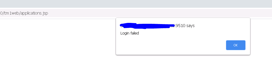

Error in TM1Web that appears after successful authentication.

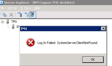

Error in Architect that appears after successful authentication.
Is there anyone else who faced this issue before? I would appreciate any responses.
