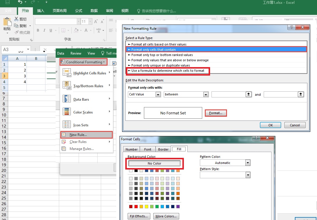

1. demo
This test rule is hide the third row when A1=1.

(1) Modify the SheetRow class in the tm1webcore.jar.
    public boolean isVisible() {
        //------add-----------
        for(SheetCell cell: m_Cells) {
             ConditionalStyle style =  cell.getConditionalStyle();
             if(style!=null) {
                  if(style.getStyle("backgroundColor").equals("transparent")) {
                        return false;
        return this.m_Visible;
(2) Modify your excel file, set background Color to no color for conditional formatting.

Post by abcthing »
I modified these pictures.
