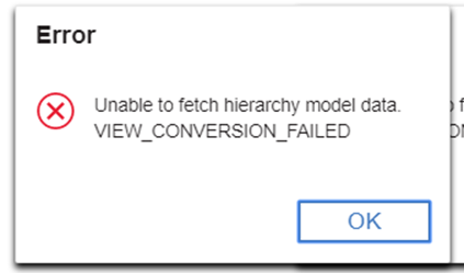

Never seen this before.. non-admin users are getting this error. Under my admin account works ok.
One would think its security related..? With a typical ambiguous error message!
PAW error: VIEW_CONVERSION_FAILED
- Capture.PNG (21.22 KiB) Viewed 3425 times

I have seen this before and it was security related. For some reason, possibly to do with performance modeler, the }DimensionSecurity cube was created which meant groups had None access to the dimensions!
The remedy was to take the server offline and delete the }DimensionSecurity cube.
