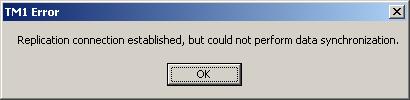

Has anyone tried using the replication & tried synchronizing the data replicated sever to the source server?
I was able to replicate the cubes...but when I tried synchronizing the replicated cube from the original cube I get this error.
Sync Error.JPG (8.42 KiB) Viewed 3113 times
Then when I check the source sever, I was disconnected...this happene everytime. So does this mean, you can just replicate and no sync the data?

seen that during my trials, check the SERVER event logs and trace an application error to the time you ran the replication. My issue was the dim rebuild was causing a rule issue so it never saved and threw a wobbly.
