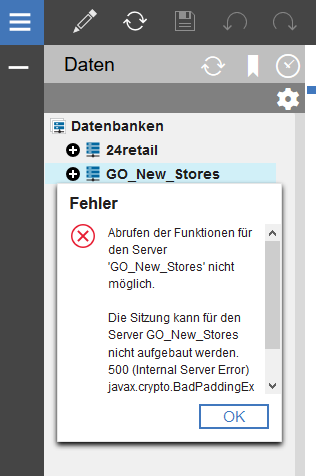

here is the message that I am getting.
2020-04-23 12_31_01-Window.png (18.12 KiB) Viewed 20908 times
Only the UI of paw is working. But nothing regarding the data. After I click on the message I only can see the servers.

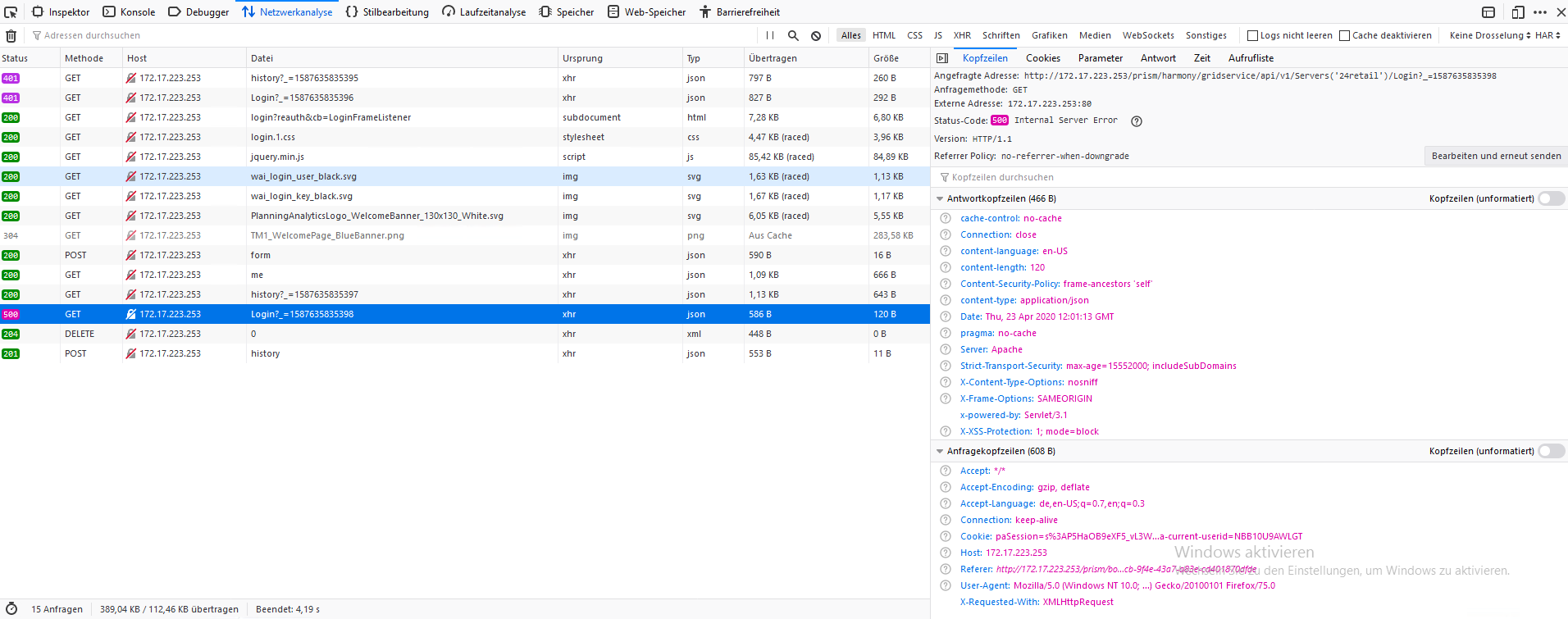

I am using Firefox. What do you mean with trying in the browser at the server directly? The browser is running on the Windows 2016 Server where I have installed PA. On this Server I also installed PAW.
In the Browser Console I found nothing special
2020-04-23 14_08_55-Window.png (103 KiB) Viewed 20908 times
