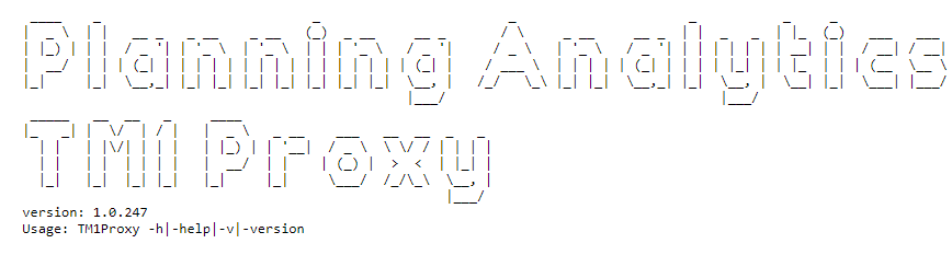

When I use the following format, the attached screenshots pops up, but it does not work beyond that.
https://customer.planning-analytics.ibm ... m/tm1/api/
Is that possible that the REST API on my cloud server is not enabled yet?

My understanding is Rest API on PA Cloud is enabled by default. However, to make it work with authentication you have to request for a non-interactive ID to be created which uses the namespace of LDAP. Only then you can use Rest API with authentication.
The screen you are seeing using "https://customer.planning-analytics.ibm ... m/tm1/api/" is normal as IBM uses proxy to redirect to Rest API port.
I can only think that the servername may be invalid to get a 404, note that it is case sensitive hence it has to be the exact name used for the setup.
Alternatively if the default instance "tm1" is active, you can test it as well.

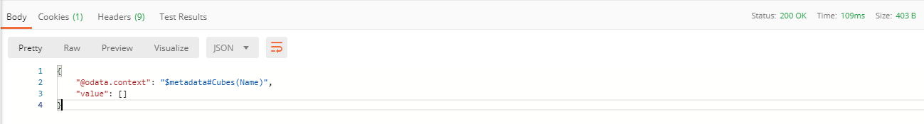

Thanks for your help, using the default instance "tm1" seems to work.
https://<<customer>>.planning-analytics.ibmcloud.com/tm1/api/tm1/api/v1/$metadata --Returns value
https://<<customer>>.planning-analytics.ibmcloud.com/tm1/api/tm1/api/v1/Configuration --Returns the correct server configuration.
However, when I try to query the actual data i.e list of cubes:
https://<<customer>>.planning-analytics.ibmcloud.com/tm1/api/tm1/api/v1/Cubes?$select=Name
it returns nothing, but status is 200 OK.
Note: I get the result of list of Cubes on web browser when using the previous wrong URL.
Is this potentially simply a blank default instance? and the actual instance is somewhere else with the unknown name? Is there anyway I can find the instance name?

Based on what you have tested, there is nothing wrong with the Rest API with your cloud subscription.
I believe you have two issues
1. wrong instance name
2. Authentication issue due to setup
If you are not the assigend PA Administrator/Modeler, suggest you get the correct instanace name from them.
Also you should read up on IBM documentation relating to non-interactive ID.
https://www.ibm.com/support/knowledgece ... count.html
All the best.
