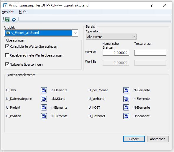

I didnt post pics of different views, because I use the exactly same view in both cases (TextExport and TI) ... hence my utter confusion.
Please find the picture of the view definition attached.
Definition is really simple. "N-Elemente" are dynamic subsets containing all leaf-level elements. U_Datenart contains a selection of 5 different elements.
@Lotsaram I tried to recreate the view with a }bedrock.cube.data.copy process, but didnt manage yet to include the subsets (basically a dynamic subset containing all N-Elements of a dimension). As far as I understood the wiki leaving the filter for said dimension empty and consolidations set to 0 should result in all leaf level elements of a dimension (which is what I need)?
Or could I simply pass the pre-created view directly to the process? If I understand the wiki correctly I dont have the option to pass an existing view to the process?

Thanks for posting the pic, I didn't realize you were using the same exact view.
For your cube copy, you'll likely want to export to csv/txt first and then import the exported file instead of intra cube copy. With heavy rules as you say, you can expect slow performance trying to read and write from same cube in the one TI process. Is it possible your original TI with terrible performance had a CellPut action? I know in your original post you mentioned it was a simple AsciiOutput, but thought I'd ask.
