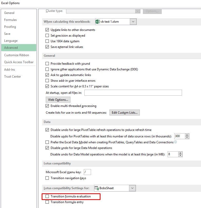

Try unticking the Transition formula evaluation box.
- Screenshot_4.png (38.79 KiB) Viewed 10720 times

It was unticked!
