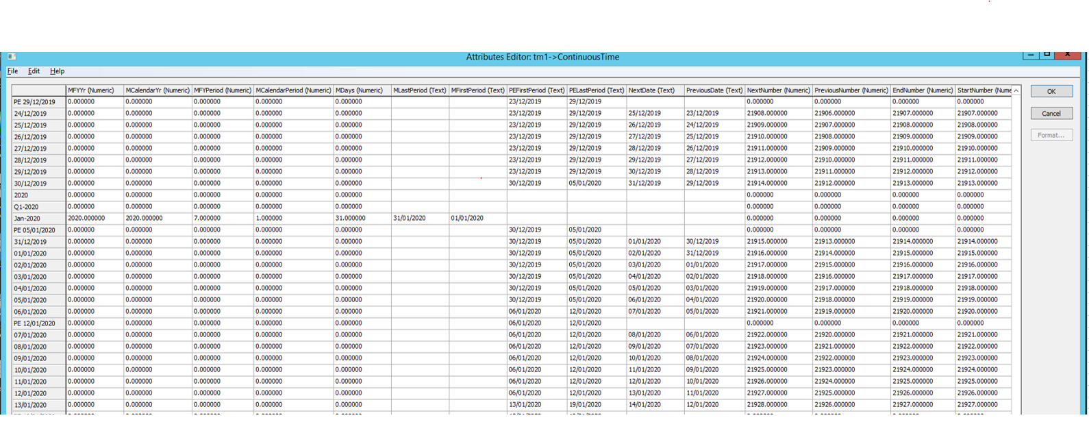

I have a question regarding how to do a dynamic YTD calculation on a continuous time dimension (not a Discrete Time Dimension).
Below are the details.
So, I have a daily labour hour cube, where using a continuous time dimension (ie, 01/07/2019, 02/07/2019, 03/07/2019 .... etc (dd/mm/yyyy)).
This cube is storing the labour hours used each day.
I want to do a maybe rule based formula, where a measure (say YTD Hours) is calculated total sum of labour hours from 1st day of financial year (01/07/2019, dd/mm/yyyy, in Australia) to whatever the current date is today ( ie something like =Today() ).
The structure of my Continuous Time Dimension is, Year -> Quarter -> Month ->PE (period ending) ->Date
The rollups only working at Year, Quarter, Month and PE level at the moment,
But I want to do a dynamic (or more flexible) YTD calculation which sum up all the level 0 elements to today's date.
In my Continuous Time Dimension Element Attributes, I have all sorts of different attributes, or please let me know if I need to create extra attributes. Please see attached screenshot of my Continuous Time Dimension Element Attributes.
Please kindly provide assist with this help.

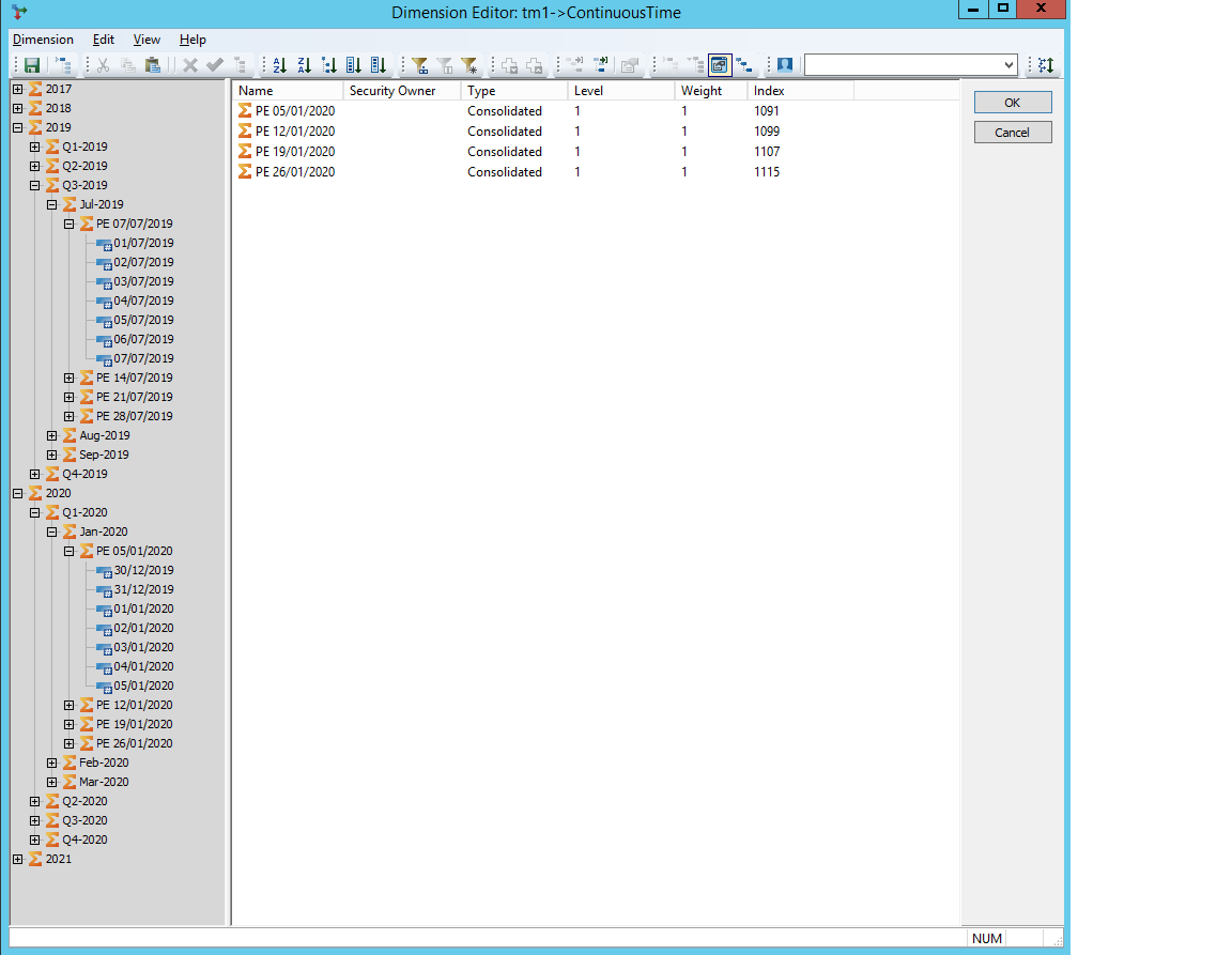

Please see the screenshot of my Continuous Time dimension, as you can see, I have calendar year layout in this time dimension.
But, the financial year in Australia is from 1st July - 30th June, so ,if I do a financial YTD is 1st July 2019 to today's date ( today's date is whatever the date that currently day)
Thank you so much.

Re: Dynamic YTD Calculation on a Continuous Time Dimension
As asked before, do you need 1 YTD (for today or yesterday for example), or each day's YTD ?
Then create a TI process that creates the YTD. You can do so by looping over dates.
You can 'unwind' that YTD total entirely (taking away all children), and add them again 1 after the other in your loop.
Or, if it's just adding 1 day at a time, you can do the DimensionElementComponentAdd of just that 1 day.
Method 1 is safer, though.
The TI process could be called from a button and/or used in a chore that runs just after midnight.
Also, like I already wrote, you can have the monthly total of fully elapsed months in the YTD. The sum total for YTD will of course be equal but the difference is if you are going to use the YTD element to allow users to drilldown. Do they want to see 1, 2, 3, ..., 365 elements, or will they expand and see elapsed months in total (where again they can drill into to see the day values).
