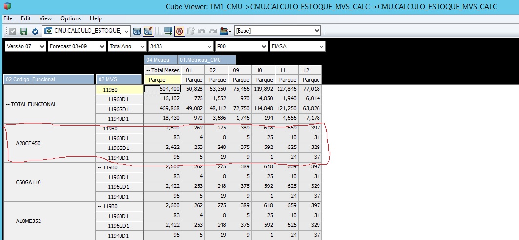

Guys, good afternoon!
I have a consolidation issue and would like your help.
Someone has had to realize this situation.
According to print, I have two dimensions (02.Functional_code and 02.MVS).
At the lowest level of functional code, the values I need are set.
When I go up to Functional Total, by hierarchical default, the values are summed in total.
But I need the values of the lowest level of functional code, as selected in red, to be replicated in Functional Total.
All the consolidation functions I have already used and did not give the expected result.
If anyone has any suggestions it will be of great help.
- Cube.jpg (145.34 KiB) Viewed 7260 times
Re: Consolidation
Show us your rules at C level.

Re: Consolidation
You should think about your approach too, what you appear to be doing is likely to be very very inefficient.
You appear to want to see the same values at all levels on the function and MVS dimensions. Even each of the dimensions only has 10 members than you are holding these data points 100 times more often than you need to.
Either do the work in another cube without those dimensions
or (perhaps more practical)
Put a "No Function" and "No MVS" member in each dimension and do the work against only those elements. You can then allow the C level rules to naturally consolidate.
Hope this Helps.
Hope this Helps.

Re: Consolidation
I think I'm with Steve on this, but if this is the structure you want, have you tried the MAX() function? Assuming not all the Functional and MVS leaves are populated, that should work. If all are populated, then simply get the values of the first component in the Total Functional consolidation. The latter would be faster, I believe, in terms of execution time.

Re: Consolidation
Hi Wim,
At level C I have only
['Functional Total', 'Park'] = C: ConsolidatedAvG (2, 'CMU.CALCULO_ESTOQUE_MVS_CALC',! 05.Version,! 05.Cenario,! 04.Month,! 04.Market,! 02 .Channel_Expenses,! 02.Group_companies,! 02.MVS,! 02.Functional_code, 'Park');
The rest of the rule is below:
['Park'] = N: IF (ATTRN ('04 .Year ',! 04.Year,' YEAR_NUMBER ')> DB (' CMU.PARAMETROS_CANAL_DESES ',! 05.Version,! 05.Scenario,' Apply Filters' ,! 02.Group_companies, 'P00', 'Year Ini') &
ATTRN ('04 .Year ',! 04.Year,' YEAR_NUMBER ') <DB (' CMU.PARAMETERS_Channel_DESES ',! 05.Version,! 05.Cenario,' Apply Filters',! 02.Group_companies, 'P00', 'Year Fin'),
DB ('CMU.PARQUE_FUNCIONAL',! 05.Version,! 05.Cenario,! 04.Month,! 04.Year, DB ('CMU.PARAMETERS_CANAL_DESES',! 05.Version,! 05.Cenario, 'Apply Filters' ,! 02.Company_Group,! 02.Channel_Expense, 'Reference Date'),
! 02.Market,! 02.Group_companies,! 02.Functional_code,! 02.MVS, 'QTY_VEI'), CONTINUE);
['Park'] = N: IF (ATTRN ('04 .Year ',! 04.Year,' YEAR_NUMBER ') = DB (' CMU.PARAMETROS_CANAL_DESES ',! 05.Version,! 05.Scenario,' Apply Filters' ,! 02.Group_companies, 'P00', 'Year Ini') &
ATTRN ('04 .Year ',! 04.Year,' YEAR_NUMBER ') = DB (' CMU.PARAMETERS_CANAL_DESHESE ',! 05.Version,! 05.Cenario,' Apply Filters',! 02.Group_companies,! 02.Channel_Expenses , 'Year Fin') &
ATTRN ('04 .Months',! 04.Months, 'Months')> = DB (' CMU.PARAMETROS_CANAL_DESESAS ',! 05.Version,! 05.Cenario,' Apply Filters',! 02.Group_companies, 'P00' , 'Month Ini') &
ATTRN ('04 .Months',! 04.Months, 'Months') <= DB (' CMU.PARAMETROS_CANAL_DESESAS ',! 05.Version,! 05.Cenario,' Apply Filters',! 02.Group_companies, 'P00' , 'Month Fin'),
DB ('CMU.PARAMETROS_CANAL_DESESAS',! 05.Version,! 05.Cenario, 'Apply Filters',! 02.Group_companies, 'P00', 'Year Ini') <> DB ('CMU.PARAM_CANAL_DESESAS',! 05. Version,! 05.Cenario, 'Apply Filters',! 02.Group_companies, 'P00', 'Year Fin'),
['Park'] = N: IF (ATTRN ('04 .Year ',! 04.Year,' YEAR_NUMBER ') = DB (' CMU.PARAMETROS_CANAL_DESES ',! 05.Version,! 05.Scenario,' Apply Filters' ,! 02.Group_companies, 'P00', 'Year Fin') &
ATTRN ('04 .Months',! 04.Months, 'Months') <= DB (' CMU.PARAMETROS_CANAL_DESESAS ',! 05.Version,! 05.Cenario,' Apply Filters',! 02.Group_companies, 'P00' , 'Month Fin') &
! 02.Market,! 02.Group_companies,! 02.Functional_code,! 02.MVS, 'QTD_VEI'), 0);

Re: Consolidation
Hi Steve,Steve Rowe wrote: ↑Fri Jan 03, 2020 2:40 pm You should think about your approach too, what you appear to be doing is likely to be very very inefficient.
Hope this Helps.
The problem is that for MVS the dimension has 3 levels.
In the image I left the totalizer hidden.
But could you better explain your suggestion anyway?

Re: Consolidation
Hi Pavoga,PavoGa wrote: ↑Fri Jan 03, 2020 7:12 pm I think I'm with Steve on this, but if this is the structure you want, have you tried the MAX() function? Assuming not all the Functional and MVS leaves are populated, that should work. If all are populated, then simply get the values of the first component in the Total Functional consolidation. The latter would be faster, I believe, in terms of execution time.
Already tried, but it did not work, because if he brings the MAX, will not meet the other items of the Hierarchy that have other values.
Since the hierarchy has 3 levels, the idea would be to replicate the values from level 0 to level 1 and this would be reflected in the "Functional Total".

Re: Consolidation
Create an element (numeric type, level 0) called 'No Function'. Add it as a child of 'Functional Total'.
That element contains the values that you now put on all the other elements. The other elements should not consolidate into the total, but the 'No Function' element should.

Re: Consolidation
Hi Wim,Wim Gielis wrote: ↑Fri Jan 03, 2020 11:28 pmCreate an element (numeric type, level 0) called 'No Function'. Add it as a child of 'Functional Total'.
It worked.
